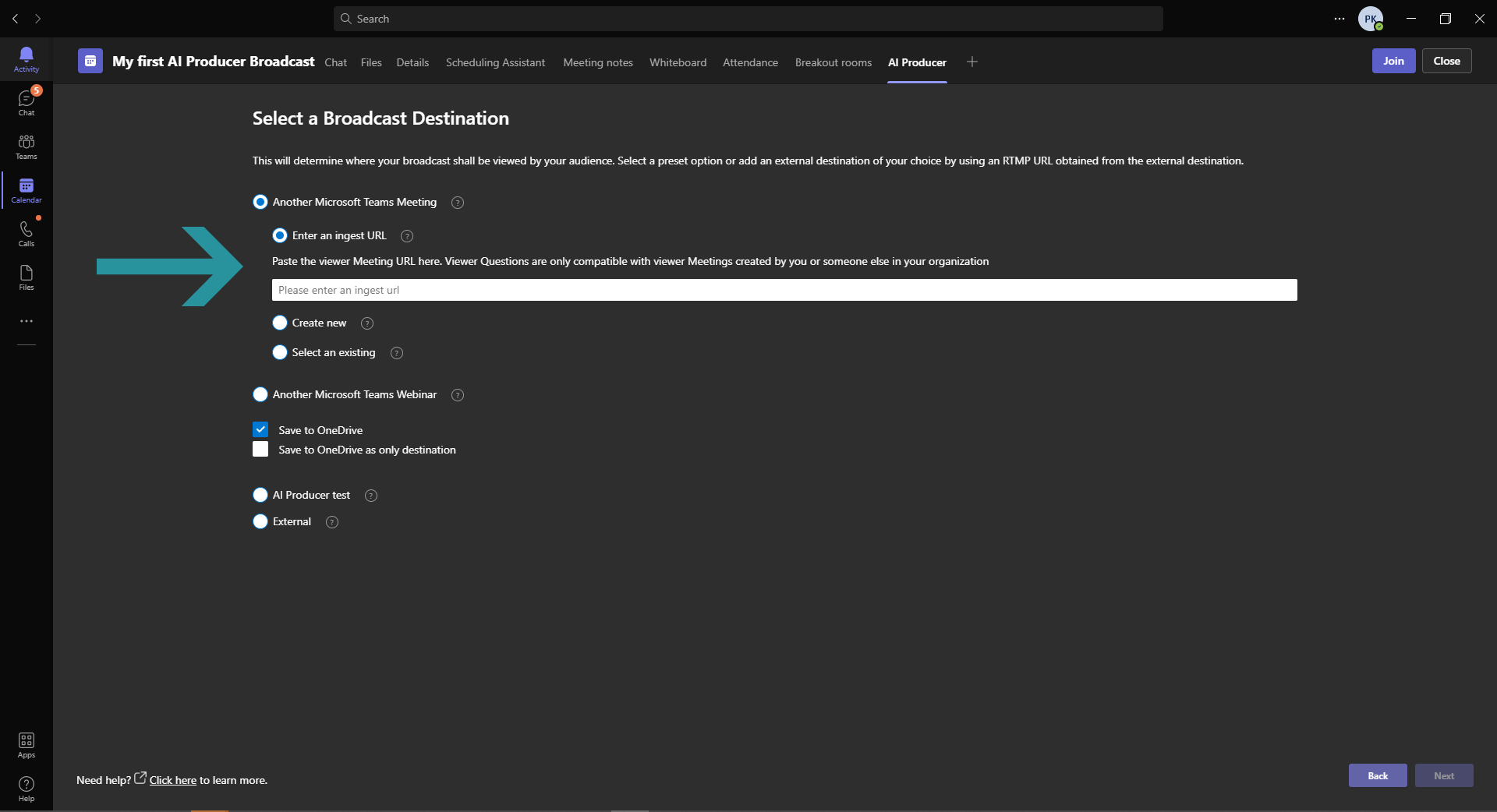

Another Microsoft Teams meeting
When selecting Another Microsoft Teams Meeting as a destination, your audience will join a separate Teams meeting to view the broadcast. You can choose between:-
Enter an ingest URL; copy the external Teams meeting URL and paste it in the ingest URL row.
Tip: Also save the broadcast to your OneDrive by checking Save to OneDrive.

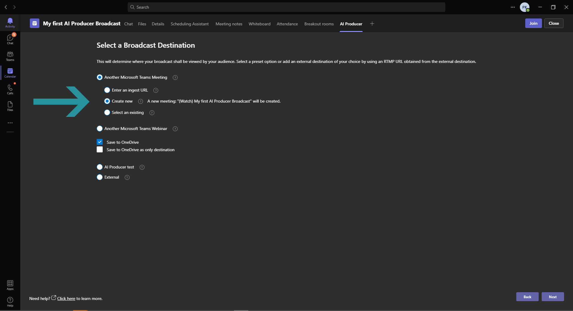

- Another Microsoft Teams meeting
Create a new meeting; where AI Producer will create a ‘Watch meeting’ for you.

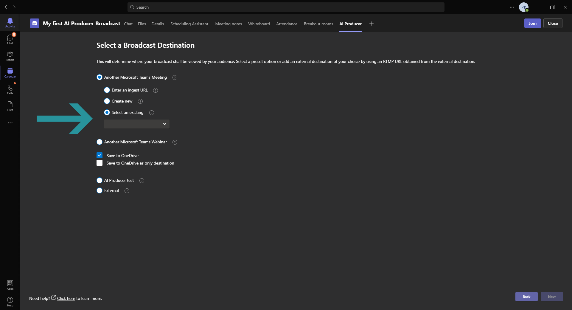

Select an existing; existing meetings around the scheduled broadcast time are selectable here.

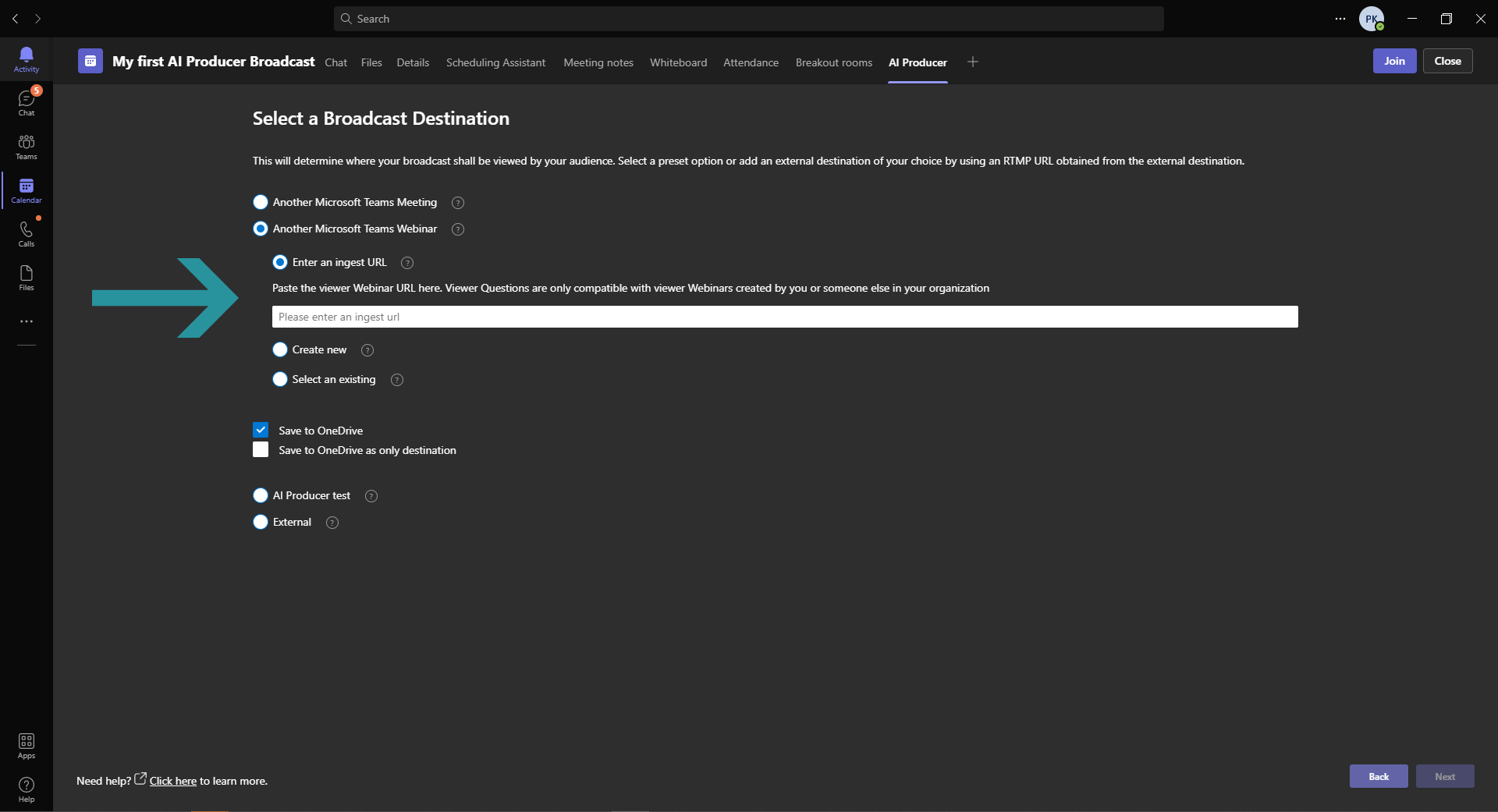

- Another Microsoft Teams webinar
When selecting Another Teams webinar as a destination, your audience will join a separate Teams webinar to watch the broadcast. To save a copy of the broadcast, be sure to select ‘Save to OneDrive’.
Tip: Viewers can spotlight AI Producer and select ‘Fit to frame’ in the viewer meeting for best quality. -
Enter an ingest URL; copy and paste the viewer webinar URL here. Note; Viewer Questions are only compatible with viewer webinars created by you or someone else in your organization.
- Tip: Also save the broadcast to your OneDrive by checking Save to OneDrive.

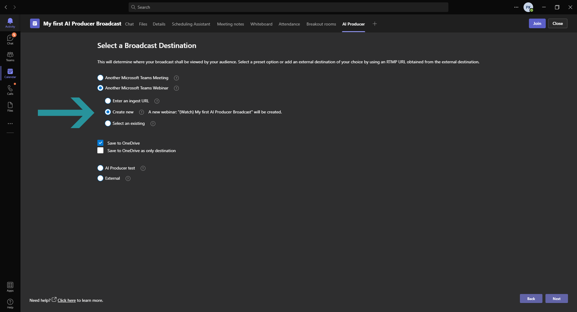

- Create a new meeting; where AI Producer will create a ‘Watch meeting’ for you.
